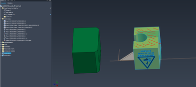

I have an assembly with multiple model states
Both model states have the same flush constraint
I had a need to do an extrude cut one of the parts by 5mm (the cut was performed on the face the flush constraint was applied to).
After doing that, the face the flush constraint was applied to is no longer there and the design doctor says there is a constraint on reference geometry that is no longer there.  So, I fix the constraint.  I only fixed it in one of the model states and forgot to fix it in the other model state (I did not know this at the time).  I noticed when I went to my higher level assemblies, they each said there was a build error (design doctor flagged a problem).  As soon as I told design doctor to accept the errors, the red cross was no longer lit up and I could not click to diagnose.  Once I realized what I had done and went back to fix the constraint in the other model state, everything was happy again.  The issue is that I would have never been able to find the problem if some time had gone by and I had to put down this work and come back to it.
