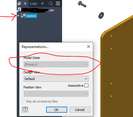

Since IPN are needed for exploded assembly drawings. To have the ability to change the model state in the IPN representation would be great. Especially since any old IPN files that are upgraded, default to the master model state. I don't want it to default to the master model state without the ability to change to a different model state.

In the nut shell:
Could you please also enable changing model states for scenes.
It will help a lot if you make for example a step by step assembly manual for the client and want to update the manual.
Version for those who have more time than tasks:
It was mentioned in old idea, which gathered quite nice support.
In those times, it was still called level of detail instead of model state.
Associative Level of Detail in IPN presentation and view linked with LoD. - Autodesk Community
As you can see below,  nothing changed except the name,
we still can't change model state for scenes.

I really wish this would be added to Inventor, the ability to switch Representations after you have already created an exploded view would be really valuable. Otherwise if you later decide to create a LOD for example and want to the IPN to reflect this visually, you need to completely rebuild.
Yijiang.Cai
@jesscadd many thanks for you sharing the idea with us! When editing scene of IPN, LOD or model state can't be changed, which is a legacy behavior. We migrate the legacy IPN with LOD selected to Inventor 2022, the LOD will be migrated to model state which is used for IPN, and it works with my testing. There is only one situation, and LOD "Suppress All CC parts" used for IPN. This will be switched to master model state when migrating to Inventor 2022. In Inventor 2022, the "Suppress All CC Parts" LOD will be migrated to design view "Hide all CC parts".
You could check it.

Thank you for the response. I understand you are matching legacy behavior. But Model States is a new feature, allow the user to have better functionality and not hamstring it with old processes. To be able to use the Model States with existing IPN files requires the existing scenes to be deleted and rebuilt from scratch. That is huge roadblock for existing designs as well as copying existing designs.

There is also small error in the picture.
I no longer had the ability to edit this idea when I noticed it.
It should be like this:
