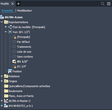

mgrenier2
Sorry for resurecting a dead thread but I would like to also be able to add the Design view name to my drawing view label instead of only the model state. I can do it using iLogic but it's annoying and it feels like I'm driving nails with a screwdriver.
