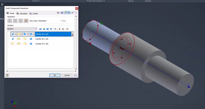

Hi @Yijiang.Cai ,

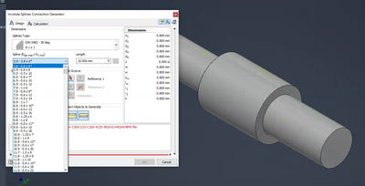

Test 1 - I copied the file as per your comments, I am able to see both DIN 5481 and DIN 5482, but there is an issue. I am unable to create any spline using DIN 5481 and DIN 5482. Inventor gets stuck and i need to crash the inventor session.

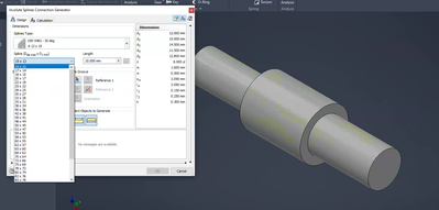

Test 2 - So one more test i did, i copied the entire Design Accelerator folder from "C:\Users\Public\Documents\Autodesk\Inventor 2026\Design Data\" to my migrated design data folder and now I am able to create the spline.
But whether Test 2 is the correct approach i don't know. Please suggest
Below is some snaps for more understanding
Used the below Shaft for both Test1 and Test2
Test 1 - Below are the images when i select the DIN 5481 and DIN 5482 (The Drop down list shows some values with *)
Test 2 - Below are the images when i select the DIN 5481 and DIN 5482 (The Drop down list got changed as shown)
Observation : In both cases, i saw the below error
Please suggest what to do next

@Pranesh_Thugru Please replace the DIN5482-30.xml file with the attached one, and also please copy DIN5481-*.xml files from design data folder for Inventor 2026 to legacy folder. As to the attachment, I can't attach it within this idea post, and attach to the post link Solved: Unable to see involute Spline DIN 5481 and 5482 after upgrading to Inventor 2026 - Autodesk ...
