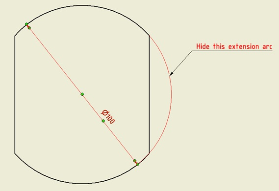

I can hide the extension lines for linear dimensions, why not for diameter dimensions?

As far as i know there is no way to edit the dimension itself, but there is a way around I use.
Create a sketch, project the geometry you would like to annotate, draw a circle, exit sketch, insert your dimension.
It should now look something like this.
Go into the sketch again and click the circle and then select "Sketch Only"
Finish sketch.
You should now have a dimension that looks as you want and it will update if the dimension of the part changes.
Enjoy!

this idea has been implemented within Autodesk Inventor 2025. Please review the Inventor 2025 What's New article here. For more information regarding how you may leverage the feature, and please review this page. Special thanks to everyone who cast a vote for it.
