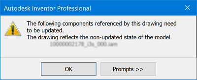

Today, Inventor shows different notifications and gives us different options if one or more sub-components have changed.

IDW
We’ll get informed about the change (message box)
We can accept or deny an update
Yellow flash (local update and / or global update) is available
Yellow flash beneath the changed object is shown
File is getting dirty (without changing something)
When opening
Yes
No
No
Yes
Yes
When already open and now activated, but a sub-component has changed in the meantime
Yes
No
No
Yes
Yes
