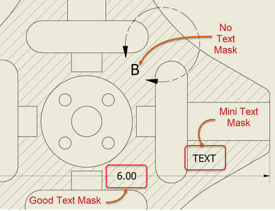

Bill_Bogan1
Here's an example. Would be nice if it was a parameter you could specify.
Dimensions have them today. Text has them but lesser so and view labels (which I think this thread is about) do not have the treatment.
Bill_Bogan1
Dimensions have masks already, text also but with near zero (tight) buffer which could be improved by providing a parameter to control the amount of (% maybe?) mask in relation to the text size. View labels, such as the Detail View, do not have the mask.
