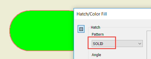

Message 6 of 11
JDMather
1. You could use a Solid fill Hatch style.
2. Are you in the Sketched Symbol environment?
1.
Message 7 of 11
eucci
doh!
I didn't see that at first 😛
Thanks!
Problem solved!
