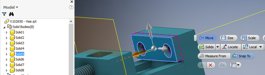

You can use the Snap To option with the Direct Edit to do this a lot better than previously available with the Move Bodies command.  Might be nice to seperate this command and call it something just for MultiBodies.  Or make it work a little better than it is now.  For example, once you get it where you want, it doesn't "lock" into that position.  Thats what assemblies are for 🙂

After attemping to use direct edit for this it is clear that it is not up to the task other than rudimentary manipulation of solid bodies. Being able to use constraints similar to the assembly environment would be a far more powerful tool.
I tried the above and it doesnt do the job.
I agree with Eucci if you can move the solid body as at present and edit the feature the I dont see why you cant constrain it
