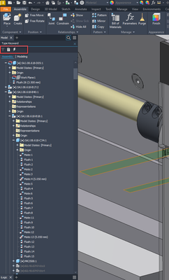

The visual  browser icon does help some, but even with that added in Inventor 2023.2, it can be difficult to find the grounded part, there makes it impossible to move things around in a big assembly with a lot of parts, as that small pin in the tree easily can be overlooked when scrolling through several pages of parts.
So it would be very nice, if we could just search for "Grounded" and it then would show all grounded parts, like it shows all parts there contains "45deg" in the attached picture, where I have searched for "45deg"
It could also be a great help, if grounded parts could be shown more clearly, maybe something like the second grounded part in the picture:

The search UI already has a couple quick symbols to filter possibly problematic parts (out of date and unresolved files), see below. Just adding one that looks like the same ground pin you put on the model icon would be a life saver.
