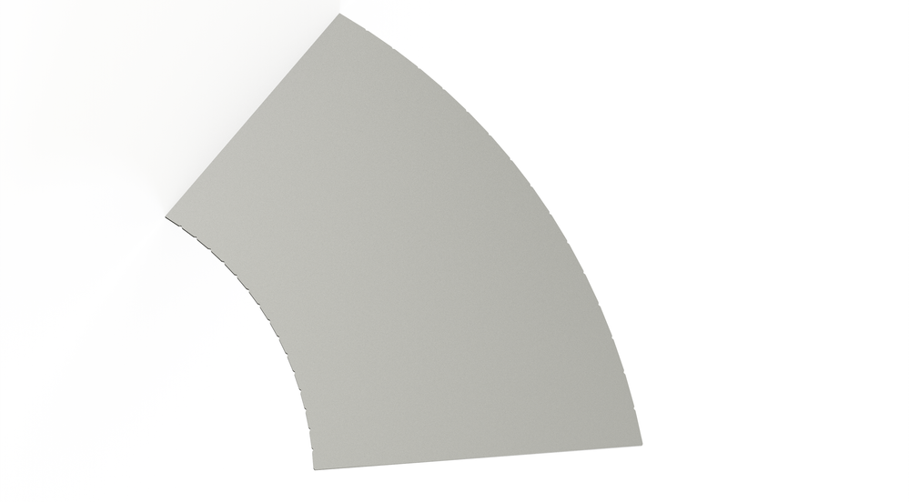

some complex sheet metal parts have no meaningful way to be formed with a traditional press brake and back gauge setup. the examples are virtually infinite, but let me point to transitions as a common one many people are likely to encounter. back gauging them is tedious at best since the part rises up more with each bend. here is what it appears as for the press brake operator:
unmarked.pngit's basically a rounded piece of steel asking for a large amount of bends. pretty tough to just run through the machine.
