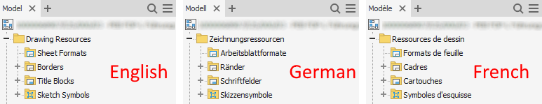

It is sometimes hard to find built-in objects, especially in multi-language environments.
As example, we have to manage the displayname of the browsernode "Sketch Symbols" in all required languages in our sourcecode.
Also, displaynames can always change in a newer release.
ExampleExample
Please provide InternalNames (ID's) for all built-in objects, but at least for ColorSchemes and BrowserNodes (or BrowserNodeDefinitions).
