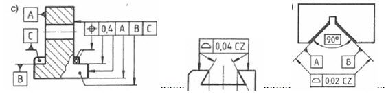

Here are some important Annotations we are not able to create in the drawing environment of Inventor.
Datum Identitier symbol:
Note: It is important for a) the perpendicularity of the reference line to the workpiece surface.
In addition, in the case of example c) and d), the dimension line for placement should be able to be trapped.
The dashed dimension line (last example) shows that the workpiece bottom is meant

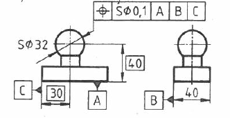

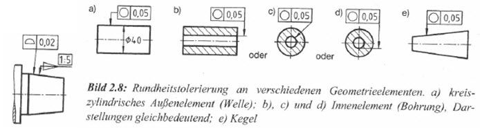

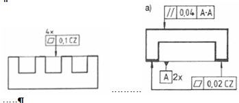

Feature Control Frame:
1. more than one arrow in different directions:
2. different arrow Placements; horizontal, vertical and a placement direction center should be easy to create
3. Since the direction of the arrow in the shape and position tolerance is decisive for the direction of the tolerance, it is important to be able to measure a diameter not only obliquely, but also horizontally and vertically
4. Here the Feature control frame is set directly to the dimension
5. With angle indication
6. A placement of a dimension line with Feature control Frame and position tolerances or coverings (without sketching of sketches) would make sense. Also a possibility for a text specification on the cover would be nice
