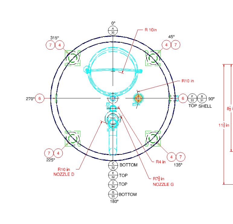

When producing orientation drawing for tanks etc it gets messy very quickly using conventional angular dimensions. That's why there is a need for angular ordinate dimensions currently I do this using the ordinate dimension then over riding the value then importing the parameter needed so its linked but this is time consuming. Please add

We currently use Inventor to design and detail tanks for fabrication.  Current practice is to dimension the angular position of fittings used on the vessel from a 0deg position on the tank.  I would like to see a radial dimension command similar to the ordinate dimension set command where you could define a 0deg position on a circular reference in the idw, then define the angular position from the zero position.  We currently have a workaround where we dimension the angle from a sketch line, and then use a custom dimension style to hide the leaders.  Very clutzy to work with.

Do you have a picture of what you are asking for?
 I don't get what you are after....
This sounds like it can be done I have a client that does tanks he never had any issues like this maybe I can see how you do it or want and see if it is the same.
When i come to dim something up in a plan view cant seem to be able to get the angles starting from a datum point.  E.g starting at zero and working clockwise back to 360°/0°  really need this as at moment its doing manually and can cuase fabrication errors when someone enters wrong text and a hole gets cut in the wrong orientation  also with the angle measurement should be able to get an arc length too so the fabricators dont have to use the calculator

In 2d (idw) file there is no option for showing true orientation. Like one hole at 0° another at 32° ...... to 360° continious.
We can not use angular dimension for so many holes. we have to shown like text (without leader & line) and there is chance to mistake to make it mannualy.

This is definitely lacking in Inventor. We have linear ordinate dimensions, we really need angular ordinate dimensions as well. We too design tanks, and before we switched to Inventor, we used angular ordinate dimensions in our AutoCAD drawings. Now that we've switched, dimensioning our nozzles and fittings has become much more messy, time-consuming, and prone to error.

All right, throwing my hat into the ring on this one.  Anyone who produces tank drawings will need the ability to create this type of dimension scheme.  It is the standard for tank design, especially for nozzle locations.  All of the discussed workarounds, and my own half baked workarounds all stink.
