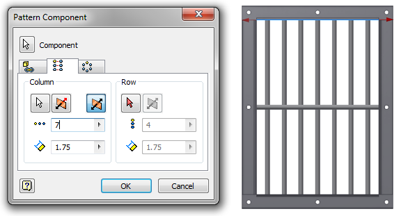

Add the "Symmetric" option to the Component Pattern dialog box.  This would allow for the correct number of components to show in the BOM when the pattern is created.  Currently, I have to use both directions to accomplish this and in turn causes my component count in the BOM to be incorrect.
Before:
After:

Hi!
I want create a symmetric rectangular series of components but I can't start selecting the central component.
I can use it only for make a rectangular series of holes (with midplane) selecting the central hole.
Is it possible?
Thank's
Nicola

This idea is based on the following link. http://forums.autodesk.com/t5/Autodesk-Inventor/Bi-Directional-Patterning/m-p/3687130#M453320 Status: Duplicate Hello, I am marking this as a duplicate of an Idea entitled "Midplane Rectangula​r pattern in an assembly " http://forums.autodesk.com/t5/Inventor-IdeaStation/Midplane-Rectangular-pattern-in-an-assembly/idi-p... Which in turn has been Accepted as [US21780]. Thanks!
Thanks for the update BryanKelley, but I do not believe that the reply marked as the "solution" accomplishes the same thing as what I am suggesting.

This Duplicate idea has been implemented within Autodesk Inventor 2016. Special thanks to the author of this Idea and likewise to everyone who cast your Kudo for it.
