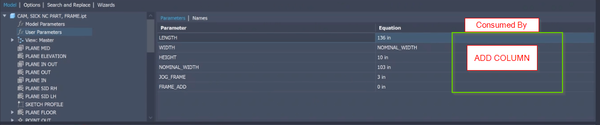

Column Example In Parameters Window
This will allow developers to see quickly if parameters are used within the model. To see if a parameter is consumed by any features you have to exit iLogic then go to the parameters window, scroll to the parameter and examine the consumed by. If the Consumed By was in the iLogic window it would make programming parts/assemblies much easier.

I have exactly the same problem. I need a way to get the values (strings) from the "Consumed by" column through iLogic. Something like:
For Each oParam in ThisDoc.Dcoument.ComponentDefinition.Parameters
     my_variable = oParam.ConsumedBy()
Next
Has someone found a solution to this?
