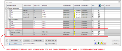

However, if you have two or more files and want to link any parameters between them (so the linked file updates when the source file changes), then you can link parameters between multiple files.
The most direct way to do this is from the Parameters window. From within the file that you want to import the parameter...
  • Open the Parameters window and click the "Link" button (bottom left corner) to open a pop-up file selector window.
  • In the pop-up, change the "Files of type" option from "Excel Files" to "Inventor Files" (side comment - not sure why it doesn't default to Inventor files...)
  • Navigate to the folder containing the IPT or IAM file you want, then select that file and hit "Open". This will open a new "Link Parameters" window.
  • Select one or more parameters that you want to link, then click "OK". A new section will be added to your Parameters showing all the parameters you linked, and these will update if the source file changes and is saved.
*Edit - the comment at the top of this first snip should say "IPT or IAM", not "IDW".
