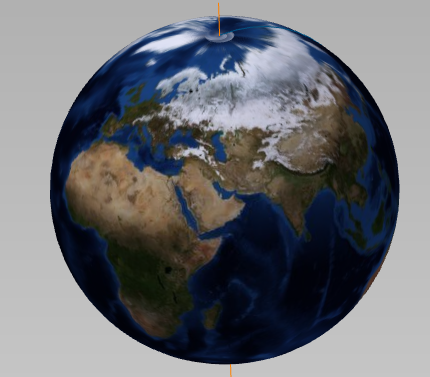

This is completely possible.  I've done it myself.  In fact, I've done a complete scale model of the solar system, each with surface textures from NASA maps/images (if they were available available).
What I did was get an image of the Earth's surface that was designed to be projected onto a sphere (there are tons available on the internet).  I saved this image into the Inventor textures folder and made an appearance style with it.  Then I applied that surface style to a sphere and, behold! Earth.
To get it to look right, I had to tweak the image scale and rotation (in Inventor's style editor).  I think I also had to modify the original image file so that the equator was at the top and bottom edges of the image.  This made it so that the image was located vertically with the poles in the right place.
I have attached the image file I used, and also the model of Earth.  In order for you to see the image when you open the part file, you will have to place the image file into your Inventor textures folder.  Mine is here (Windows 7):
C:\Users\Public\Documents\Autodesk\Inventor 2012\Textures\surfaces
Edit:  Here is a screenshot so you can see what I see when I open the part file:
I think the texture is actually upside down (at least from a northerner's perspective, with Antarctica on the top), but this was easy enough to fix with constraints in the assembly that I didn't bother to fix the image.

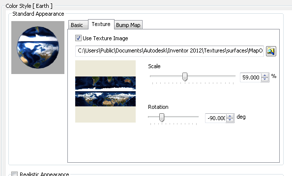

You can probably just edit the appearance style to rotate the image (and scale it).  Here are the exact settings I used to get what you seen in the image from my earlier post:
You may need to use a different scale, depending on the radius of your sphere.  For your reference, my sphere is 1" radius.  But setting the image rotation to 90 degrees (or maybe -90) should line it up properly.
