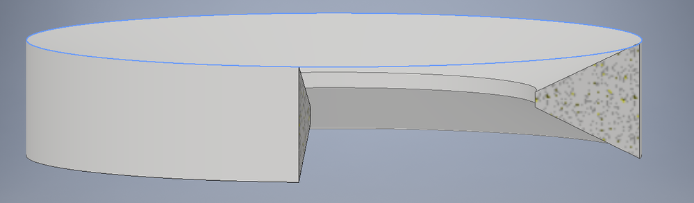

So there is no simple way to create a work plane on circular edge (as shown selected on the image below)? The circular edge defines a plane and this should be no brainer......
The only way i was able to achieve this is by having another sketch at 90 degree from the original (vertical), then project geometry onto it, and use those projected lines to create a plane i need... but this is ridiculous..

it's a makeshift part. revolve a triangular sketch and see about placing a work plane on circular edge

@Anonymous I think you are having a problem creating a plane along the blue circumference line?
  • Turn on the visibility of your revolved sketch
  • Select Create Plane
  • Select the top right point of the revolved triangle
  • Select the plane from the Origin
Hope that helps!

Thanks @kelly.young This did work. Granted , it's just a matter of few mouse clicks, but, the edge is defined by the sketch, so why can't you place a plane on the revolved edge? As @johnsonshiue said, speaking pure math, circle defines a whole lot of things. So that should be used to further improve Inventor capabilities... This way, it is just another workaround..
