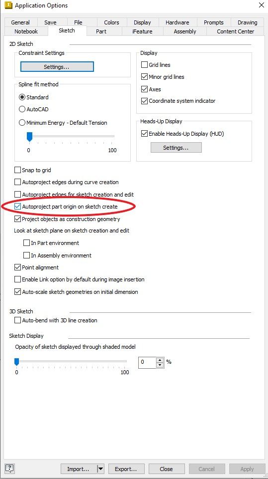

Frederick_Law
Something wrong with the background point selection.
When there is a point, it'll select that point.
When there is no point, it'll project one.
I use auto Project Origin:
Message 7 of 8
Darkforce_the_ilogic_guy
This is also active on my computer
