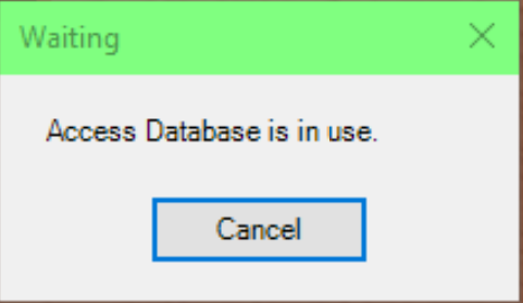

This is the path to the content center files in my current project. C:\Users\seanj\Documents\Inventor\Content Center Files\R2021\
I try to do a part as custom, but it keeps hanging up Inventor. Please see the attached screen shots.

….but it keeps hanging up Inventor. Please see the attached screen shots.
Not sure what this is about...

Hi Sean,
You might need to install or reinstall MS Access Engine 2016. Please make sure all critical Windows updates are installed and the following procedure is performed.

I still get the access database window when I try to place a custom part from the content center. I uninstalled and reinstalled the Microsoft Access database engine 2016. What else should I do?

as a workaround, you could place CC parts As Standard (I think that is working for you) and then File>Save Copy As to your local project folder and then replace in the assembly.  I bit of extra work for sure, but this would give you local content divorced from the CC library.  For your small project it should only be a minor irritation.

Does the CC part contain an iLogic rule or Macro? Please share an example file here.

Unfortunately, the information you provided so far isn't actionable, because we cannot reproduce the behavior. If possible, please share the custom .idcl file or the original ipt file you used to publish to custom CC library. Send them to me directly ([email protected]).
In the meantime, please make sure all critical Windows updates are installed.
