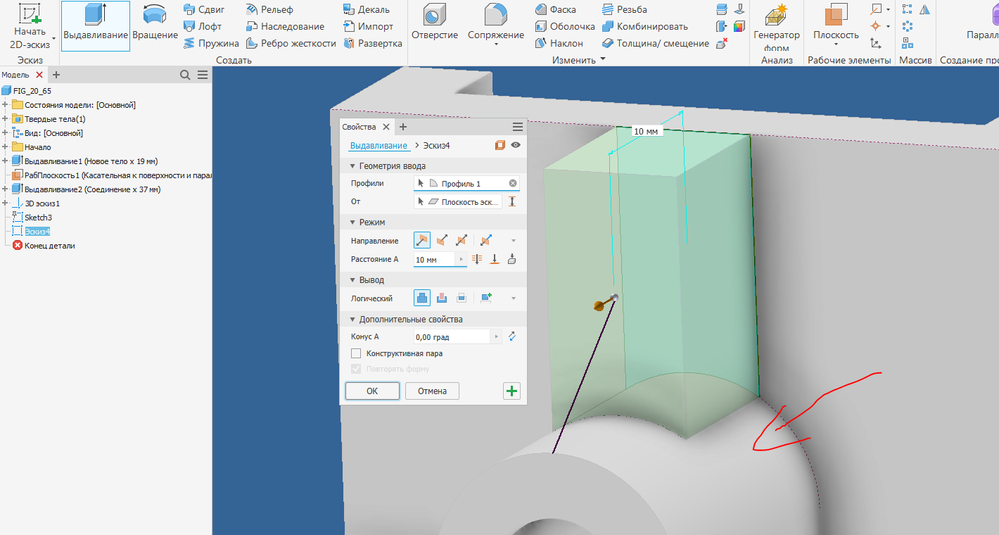

With regard to attached part file, why can't I create a rib for "Sketch3", or how do I create a rib.
Edit:
I have also attached the part which I was trying to draw. Only the rib feature is remaining.

I also thought of extrusion, but the bottom side does not blend with the slotted projection. It is straight, while the slot projection is circular. There remains a gap between rib and the bottom surface.

Alexander_Chernikov
When used the loft - will not have a flat top face at the Rib.
Alternatively, you can provide a small gap (depending on the radius of the cylindrical face and the width of the rib) when you sketch the rib axis.

I have edited my question to include the drawing figure. You can see that it is a simple rib which ideally should be designed in inventor by using the Rib feature. Hence, I would like the respondents to suggest a solution using the "Rib" feature.

Hi! The rib in this case cannot go for the full length. Or it will alter the circular edge at the top. The rib sketch needs to offset inward a bit.

I made the sketch line a bit offset at both ends, still inventor won't create the rib.

Alexander_Chernikov
You should pay attention to 2 options for Rib:
the position of the Rib relative to the sketch plane and the direction of creation of this Rib.
Watch attached video
PS.: Check that your coordinate planes coincide with the planes of symmetry of the part!
