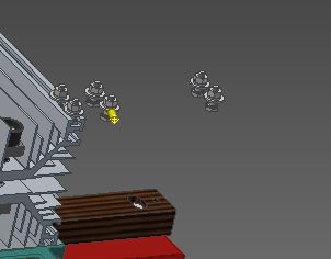

So I am trying to create some iLogic rules and I already hit an issue. I have an iAssembly with 2 parts in it 750650110 and 750650111. This iAssembly is in my final iAssembly and I am trying to very basically create 2 final assembly configurations. When I select the version that uses the 750650110, I want the hardware that is specific to the 750650111 to disable by an iLogic rule.  This 1 rule alone would save me 17 table entries and that isn't even factoring in the constraints. 1 Model file to rule all of the configurations is the best thing since 3D CAD if it can actually work.
When I run the rule the parts disappear, but they do not exclude. When I rebuild the model they reappear. So it is trying to work but not quite there.

I feel like you didn't read or didn't understand my last message.
There is nothing in the ilogic tools to help you configure the ipart/iassembly table. There are some iLogic ipart/iassembly functions that will allow you to change from one member to another once you have the tables configured, but that is it.
I think this is a misunderstanding going both ways. I do not want to use iLogic to modify or generate the tables. I want to use it to include or exclude all of the hardware and simple parts that go with a specific table configuration but are not in the table. iLogic has an enable feature to it, so I am not understanding why this will not work.
Having the ".Excluded = True" as part of iLogic  leads me to believe that iLogic can control weather a part is included or excluded in an assembly, same as a table entry would do, without having to use a table entry for that item using the iLogic to perform these tasks automatically.
Component.InventorComponent("RING TERMINAL .25 12-10GA RING TERMINAL .25 12-10GA-Silver:3").Excluded = True
This brings back my question of how assemblies with 100's of configurations should be handled. The Boss doesn't want to hear that it will take a month to update all of the models and prints to add a freaking decal to all of machines. There has to be a more efficient way to do this. How does everyone else deal with this?
I want ONLY these options in my final iAssembly table to choose from:
Transformer (1-10)
Bridge (1-2)
Output Style (1-4)
UI Style (1-3)
Based on what options I select in the table, I want the associated pieces to "know" if they belong in that configuration or not. Is that not what iLogic was designed for?

In an iAssembly if you exclude a screw from your assembly then it will do that for all member rows, if you want to control that screw differently for each member row, then you have to put the Include/Exclude column for that particular screw in your iAssembly table, any and all differences between member rows have to be represented in the table, iLogic cannot help you get around that.  If you want to use iLogic to control your top level assembly it cannot be an iAssembly, it'll be just a regular assembly with some iLogic code to automate your manual labor such as configuring your assembly.
Either the API for easy edit of iAssembly tables isn't available or isn't exposed to the user, I've tried using iLogic to configure iPart/iAssembly tables in the past.  It's a fool's errand imo so iAssembly is just a library tool.
Could you provide an example or picture of what you're configuring with iLogic?  I'll see if I can provide an example of what I'm trying to explain, I know I'm not the best teacher.
