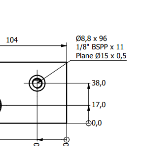

I'm a former Creo user . I used to design manifolds and valve blocks.
I created my own UDF (holes and cavities) which had its 3D note on it.
3D notes had all parametric data needed to define the hole (or cavity)
After finishing my part I would create a 2D drawing and all part's 3D notes would appear automatically on the 2D-drawing.
That was not a standard in Creo but something that we created our self.
It made our job very effective.
I would like to do the same in Inventor. I do not know where to start.
To start with something simple I would bring an example:
I would create a UDF what helps me to create hole whith following dimensions:
Ø8,8 x 96
1/8" BSPP x 11
Plane Ø15 x 0,5           My system is metric but I use BSPP threads
I know there is a simple way in Inventor to create this hole but my goal is have it with 3D note that appears on drawing afterwards.
This is how it looks on the drawing.
If I go back to my part I could change let's say my plane to be 3 mm deep and since note uses parametric values drawing would update automatically..

I think what you're looking for is defining a new Hole Chart sheet (tab) onto the existing library one, as shown in this video:
Plus modifying the style for hole annotation to include/organize any information according to your preference:
https://knowledge.autodesk.com/support/inventor/learn-explore/caas/CloudHelp/cloudhelp/2022/ENU/Inve...
Reference for hole note icons:
Please let me know if you need more guidance on how to build those. I don't have my work PC on right now to screenshot examples.

I wonder if Inventor's iFeature functionality is part of the answer.  Look in the Help here.  This allows you to define your hole as a feature and place it wherever you wish.  It does not, however, contain the 3D annotations.  If the thread is non-standard, then you can add it to the thread table in thread.xls, located in C:\Users\Public\Documents\Autodesk\Inventor 20xx\Design Data\XLS\language\.

It really looks exackly alike Creo-UDF I was familiar with.
3D note is not something I have to have. It was just one method to get done 2D drawing very fast.
