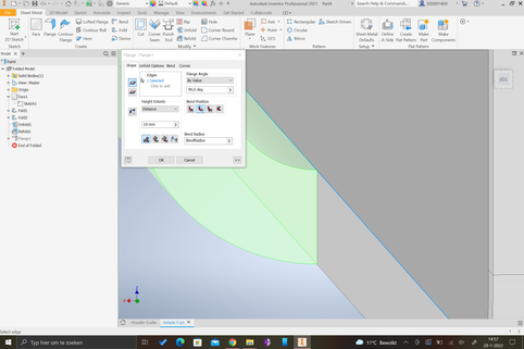

I'm making a school project where one of the parts has a bend on one of its corner. I saw on a YouTube video where the guy used flange to create the bend. He didn't mention how to get rid of the relief shape. Is there any way to make the bend without the shape?

I think these are the settings you're looking for:
Right click the feature, click the Bend tab and set A and B to 0 (for this feature only).
There are default settings available as well, if you're brave enough to tamper with those 🙂
302891469
Thanks it worked. I could only change B to 0, but that was enough.
