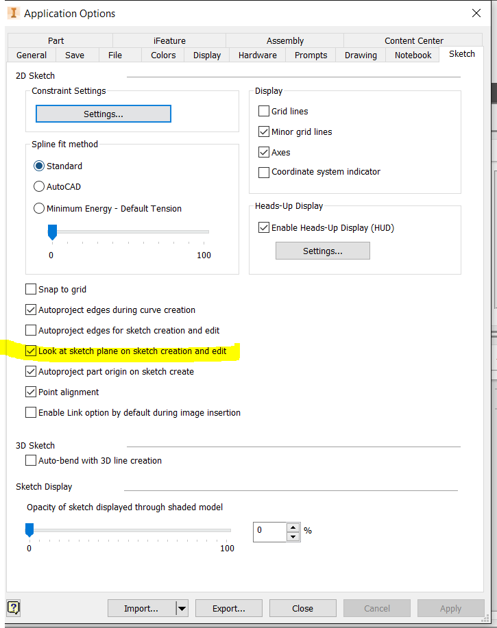

mdavis22569
Turn off the auto look at in application options

machiel.veldkamp
Yeah that's not it. I have that turned off for years.
