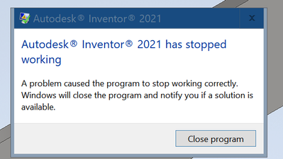

No VB or iLogic involved. In further investigation, I see that it's actually not creating the iPart, and there is an (as yet, unknown) issue with Excel. Creating an iPart is now crashing Inventor. Excel won't start on its own, although it starts and runs an instance in the background (according to task manager) each time it's been called from Inventor or with start program. I've done the latest Windows updates, and I'm digging a little deeper.

Well. Nope. This is after the Inventor re-registration you suggested. Now back to Excel.

3D4Play
Opened fine, just crashed when I tried to create the iPart

Hi! Have you installed the latest MS Office Update? The crash seems to indicate Inventor.exe is blocked from starting up Excel.exe. Try a few other things.
1) Run Inventor.exe as admin.
2) Go to Control Panel -> System -> Advanded System Settings -> Environment Variables -> create "UseLibXL" and set its value to "False", not '0'
Many thanks!

That did not work. I had in the past used the UseLibXL environment variable but cleared it when I upgraded to 2020. I've had no issues until this started a few days ago.

Hi! For 2020, "UseLibXL" needs to be set to '0.' For 2021, it needs to be set to "False."
