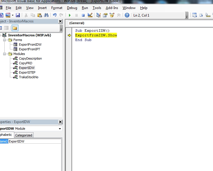

Just want to add some screenshots
Then when I click debug:
2015-05-05 06_34_42-Microsoft Visual Basic for Applications - WIP.ivb [break] - [ExportIDW (Code)].jpg
And crash:

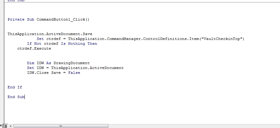

Code:
2015-05-05 06_37_19-Microsoft Visual Basic for Applications - WIP.ivb - [ExportFromIDW (Code)].jpg
Hi guys I just add line to :
Line added : On Error Resume Next
Sub ExportIDW()
ExportFromIDW.Show
End Sub
It looks like it works ok now. Is that ok?
