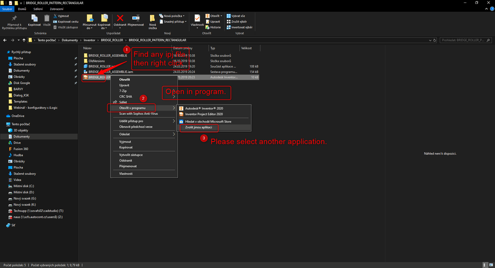

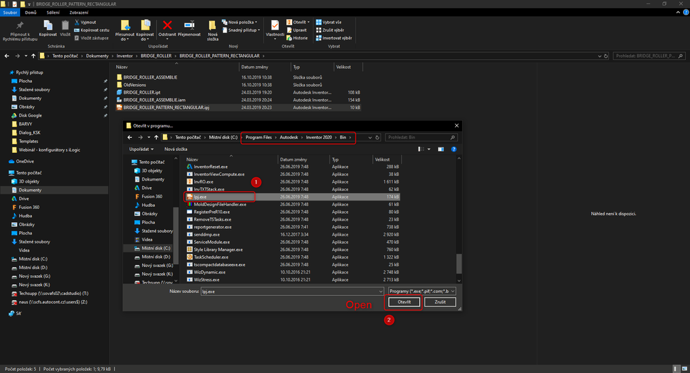

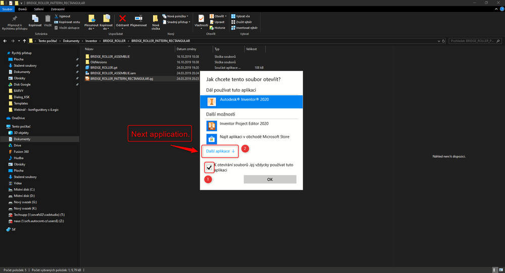

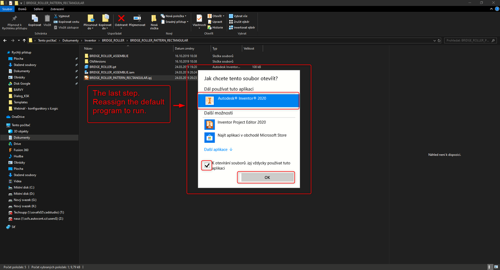

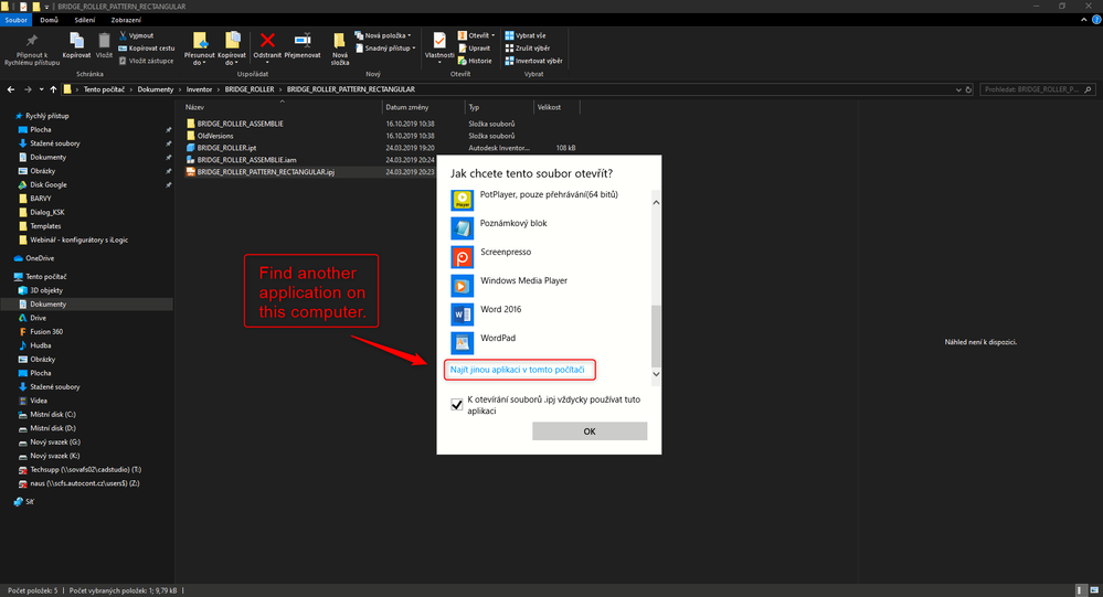

I have the same problem, it does not work. I use it when working on multiple projects. I have been working in Inventor since version 6. I used to use the double clicking on ipj's too, and must confirm that it has stopped working on my side too. Inv2020.1
Here are some examples of functionalities cancellation.
Forceeffect Canceled, Auto Explode in Inventor Canceled, and much else Canceled. I expected that this functionality will be integrated into Inventor and developed and nothing.
This world understand.
For guides and plans. = Arbortext IsoDraw (Publisher Canceled, Showcase Canceled,)
https://forums.autodesk.com/t5/inventor-ideas/bring-back-the-auto-explode-in-ipn/idc-p/9037902/highl...
Message 16 of 35
dusan.naus.trz
I tried this. According to the picture.
It works for me now. Please try it all.

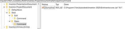

Nevertheless, something touched me and I looked into the windows registry. The key branch [HKEY_CLASSES_ROOT \ Inventor.ProjectDocument \ Shell \ Open \ Command] contains a default value: "C:\\Program Files\\Autodesk\\Inventor 2020\\BinInventor.exe /pf \"%1\"". The problem is that there is no such file in my system (under the name BinInventor.exe). I get the impression that the last update removed it and this is the source of my problem.
Can anyone confirm this and possibly give me the BinInventor.exe file for Inventor Release 2020.1.1. (Build 239)?

I have version 2020.1.1 and it works for me. I hope you made the association for Ipj.exe and then the association for Inventor. exe. You have to make 2 associations. And you must have update 2020.1.1
Sending file in attachment. But I don't understand how it will help you and why don't you want an update?
