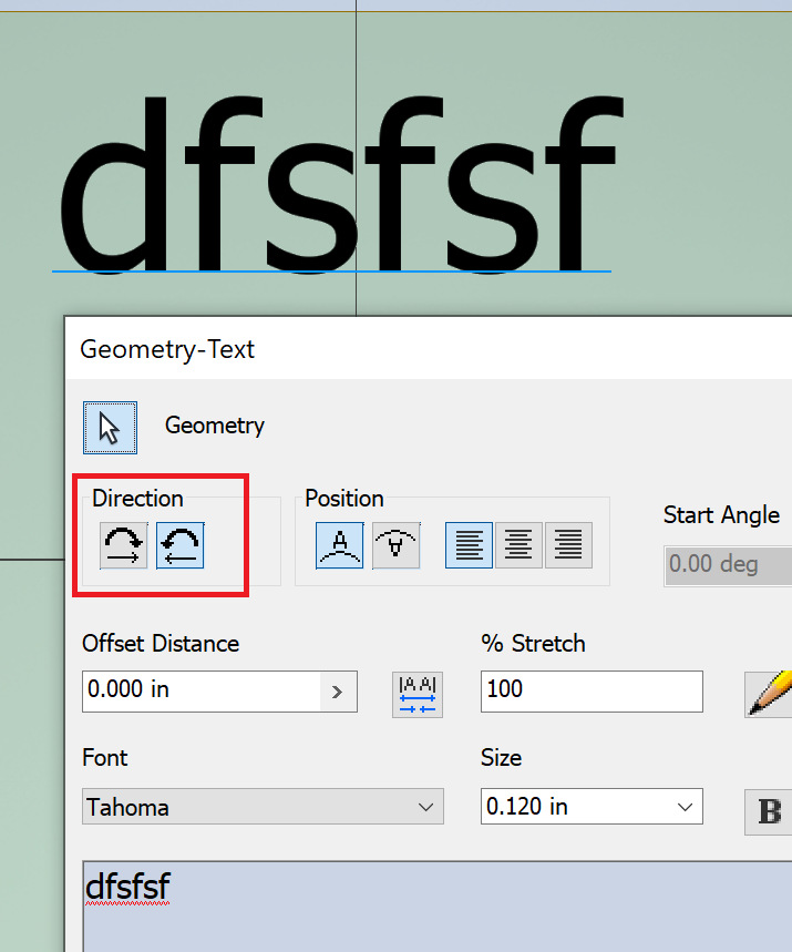

@Vagulus ,
You can also try with Geometry Text and flip the direction. Try to drawing a line first and make a Geometry text instead.

Xun.Zhang
Hello @Vagulus ,
Above two solutions are working well.
Check out the enclosed file for reference.
Hope it helps!
Xun

Xun.Zhang
Hello @Vagulus,
Here are two videos for your reference.
1. Geometry text alignment
https://autode.sk/2uDiEUk
2. Flip normal
https://autode.sk/2CMzHHL
Hope those are help!
