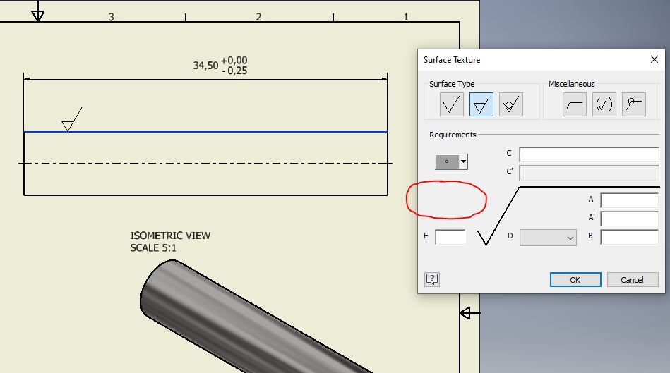

I'm trying to give my pin here a surface roughness of 32 um, but I seem to be missing dialogue boxes, compared to others. I've tried giving the model a surface roughness but to no avail, then I tried in the drawing.
What I want is essentially upper and lower limit surface roughness (32-63)
See attached picture. Have I missed something important or is it a bug?
Best regards, Fredrik
1,256 Views
Further I will add that I do not seem to have a drop down menu at the top, showing various presets, that others seem to have.

Hi Frederik,
it seems that you have active annotation standard which does not support it. Go to the Styles Editor and active annotation standard, for Surface Texture Symbols,  to ANSI or to  ANSI-mm. Annotation standard can be changed also in the Ribbon>Documents Settings>Annotations.
Regards,
Martin
