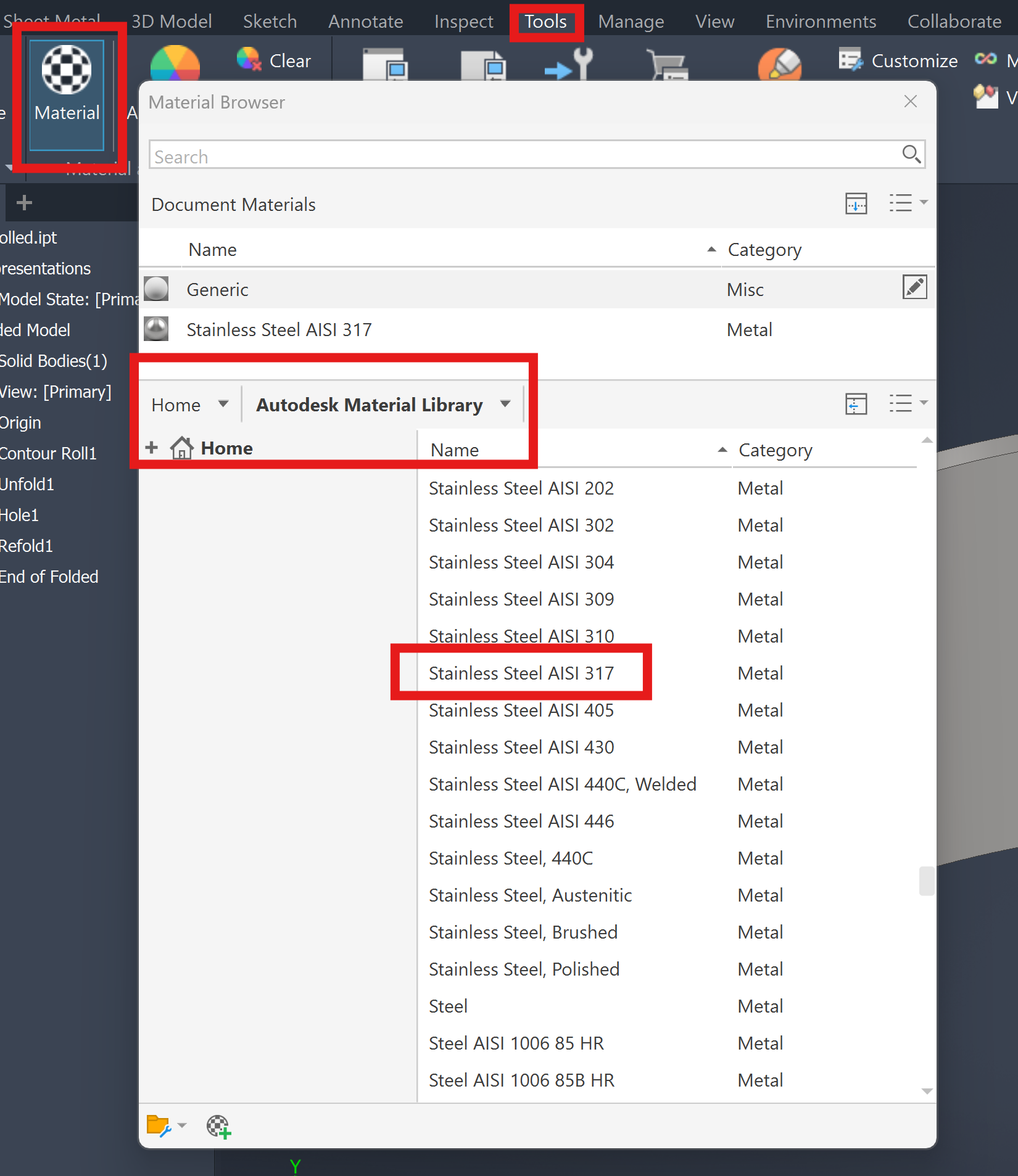

Why is there 317 stainless steel in the standard autodesk material library? It should be 316, right?
How can I change it in the standard material library?

Yes, sorry.... this material is actually found in the Autodesk Material library, not the Inventor Material library.  When you place your cursor over the material, you will see the "pencil" icon next to it for editing.

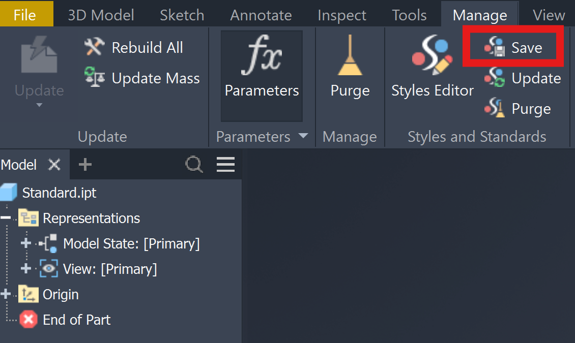

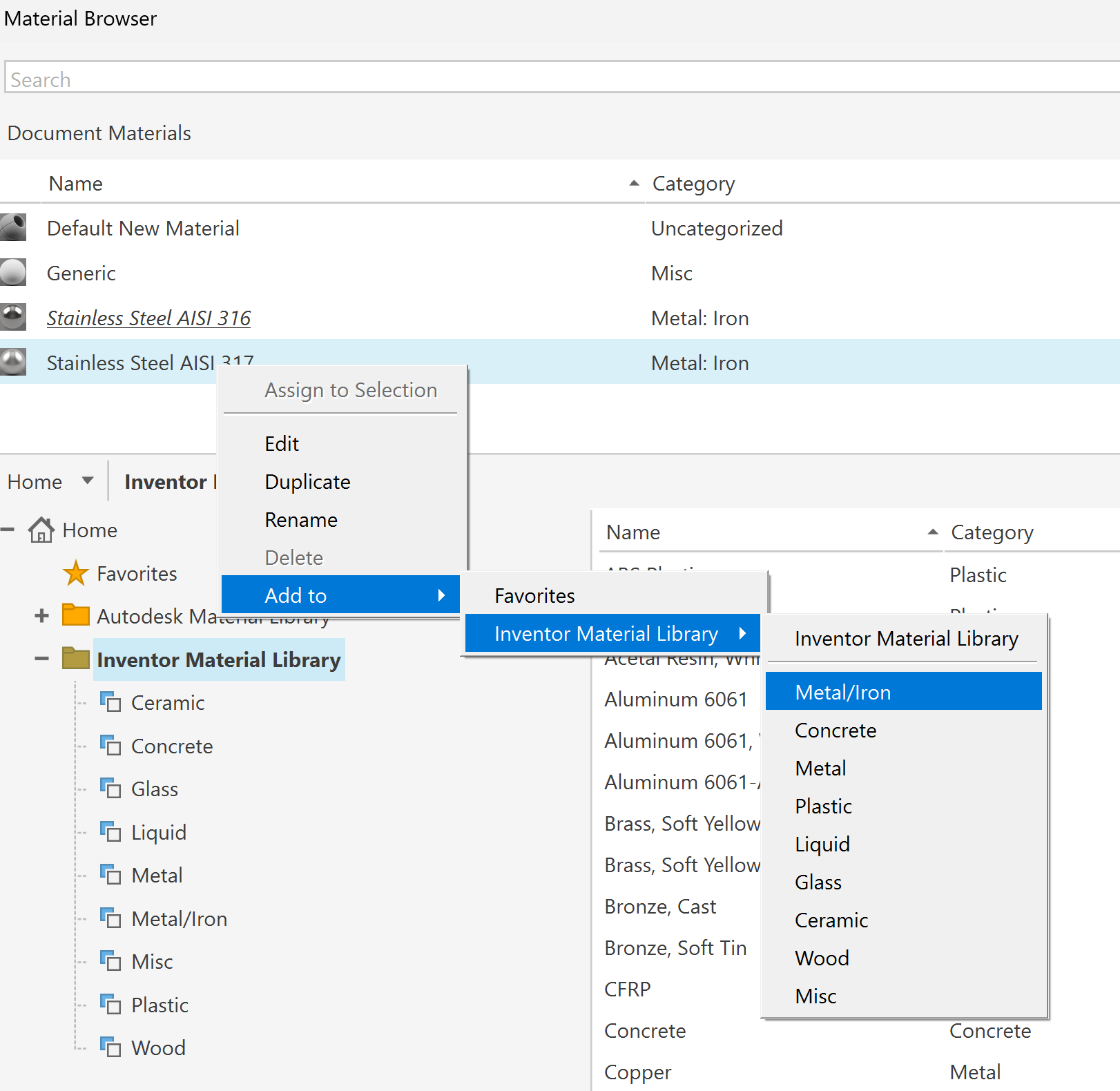

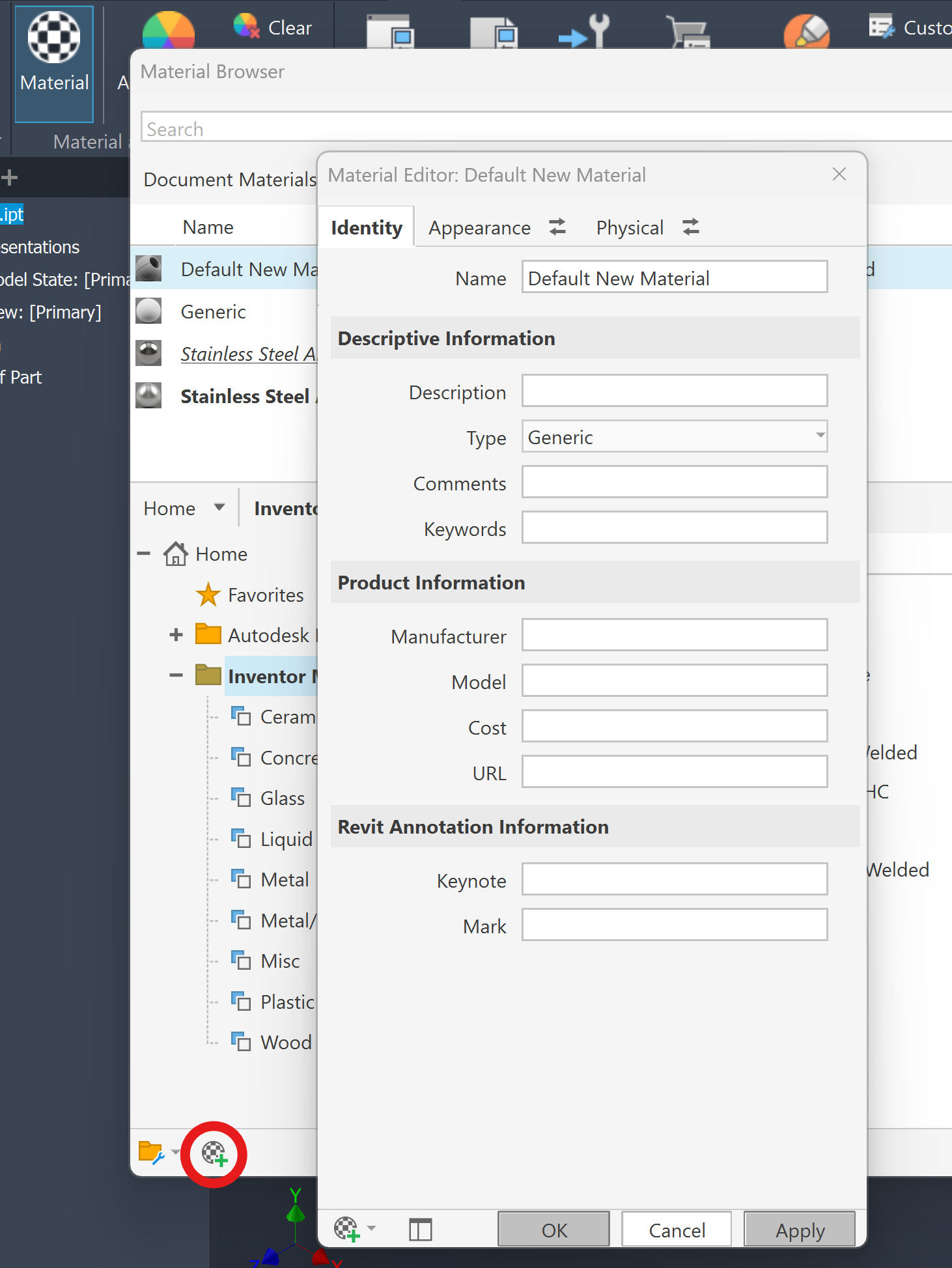

I just tried with this workflow.  The Autodesk Materials library is locked, so I had to create a new material in the Document (I did this in the part template).  You could also find the 317 material in the Autodesk Library and copy it to the Document, and then Edit it into a 316.  Once the material is in the Document and all of the information is set the way you want it for the 316, you can right click to add it to the Inventor Material library.  Once you have it in the Library, go to Manage\Styles & Standards and click on the Save tool.  This will show you that there is a mis-match between the saved styles, and the Styles in the template.  Say yes and hit save  It will warn you that this cannot be undone, but that's ok.  This will make the 316 you just created available in all new parts.
