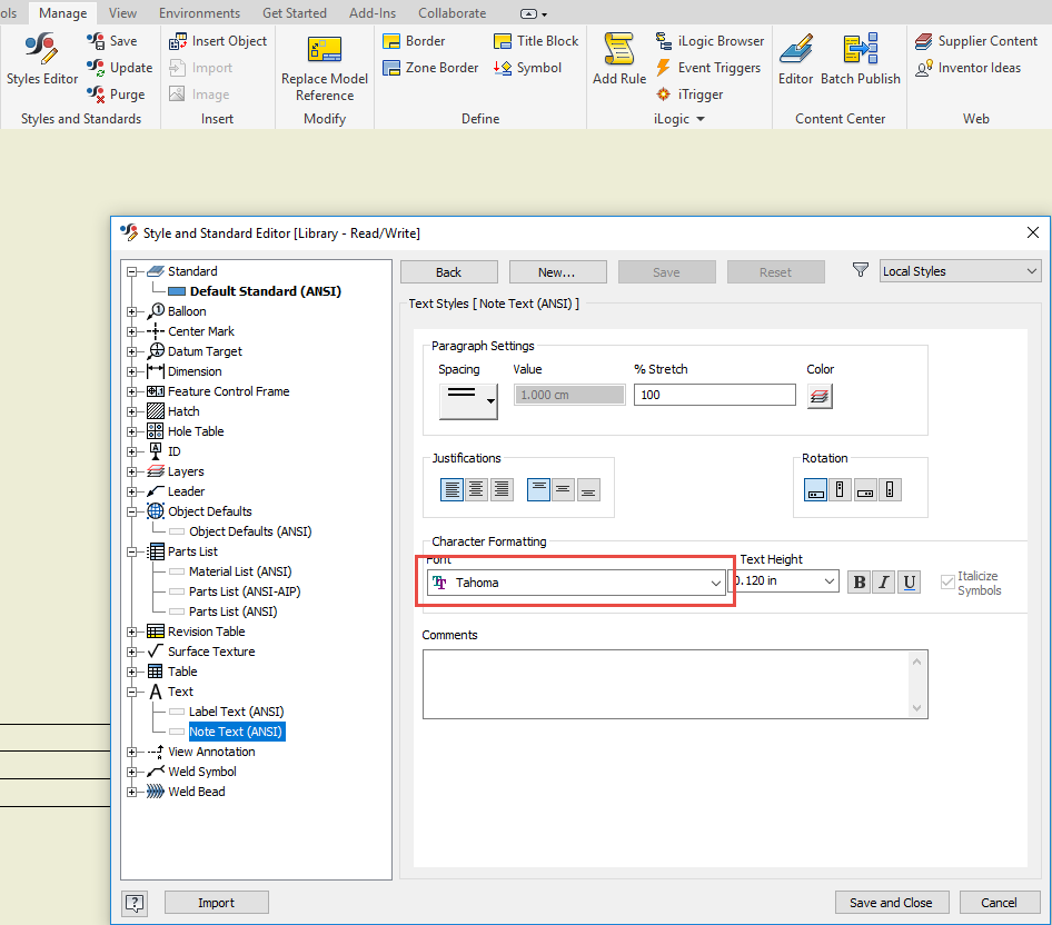

@0x3FA5 I will escalate your second question to support as well and do my best to help you with it. As for your first question, since you are coming from a third party software you might want to familiarize yourself with how styles and standards work within Inventor as they aren't necessarily the same. I found the Neil Cross tutorial video to be very helpful.
That being said, you will need to create a custom style that reflects the font that you are attempting to use. changing style standards for parts list.png
In the image above you can see how to access these standards and where the defaults are set. If you click the pencil icon next to Data, you can edit what will be filled within the Parts List. Just make sure they are set as object defaults and you might want to make a template.
Above you can see the text formatting, and this is where you will change the font like @SBix26 was explaining.
Please let me know if this answers your question. Thanks!
