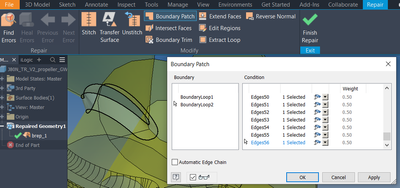

My preferred way to fix this is by using the Repair Geometry environment. However, after unstitching the hole solid, deleting all the fillet surfaces and using boundary patch to re-patch the areas (it was a pain to finish these because the automatic edge chain would not work on the blade's side), I still got a resulting multi-face fillet instead of a smooth single-face...

Interesting model. I think the translation of those fillet (blend) surfaces does look bad indeed along with those tiny gaps. On the surface, it looks like those surfaces somehow translated disjoint but they do appear to maintain continuity. I believe we already try to heal it on import but in this case, those tiny faces are not merged back.
If you look at the fixed up model from @Gabriel_Watson and try to STEP-out the model and import it back into Inventor, those fillets come back in fine.
I would check the original model on the authoring CAD system to see how they the surfaces look like and whether the problem is in the definition of those surfaces or the STEP export operation.

I asked our translation team to take a closer look at the STEP file and they confirmed my original thoughts on those blend surfaces being discontinous. It looks like at translation, we split the original blend surface because of several non-g1 discontuinities. At each discontuinity we split the surface and end up with several pieces. While its not ideal, it also helps prevent creating bad bodies. We can certainly take a closer look at the step file and see if we can play around and produce a better model. But ultimately, I would really take a closer look at the original model from the original cad system which produced the step file.
