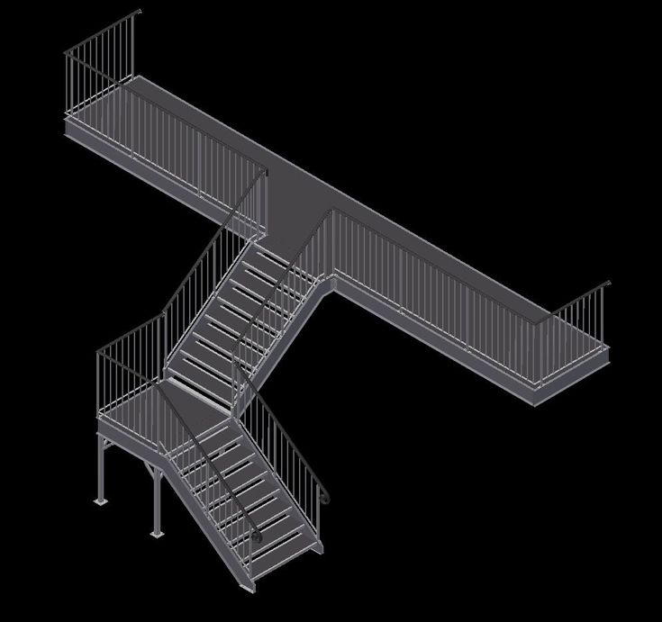

There are other approaches to designing railings, depending on the client's wishes, manufacturability, etc. If you design the railing using the OSHA 4" gap specification (so that a baby's head cannot fit through, as it was explained to me by a contractor), this means that the picket spacing will vary depending on the picket dimensions. If the design is based upon the 4" gap, using 3/4" steel tubing for the pickets, the picket spacing will be 4 3/4". If you are using 2x2 lumber, then the picket spacing will be 5 1/2". Conversely, designing to the 4" picket spacing, using 3/4" tubing will give a gap of 3 1/4" and 2x2 lumber gives a 2 1/2" gap.
One client has this project where they were replacing existing railings, all of varying lengths. He did not want any of the railings to turn a corner. Straight runs only. For each corner where 2 railings met, the top handrails were to be mitered. He was having these manufactured overseas, and wanted to minimize shipping costs. I modeled 2 versions of one length of railing. For the 1st, the gap was spec'd at 4". The end gaps ended up being roughly 2 3/4"". For the 2nd, all of the gaps were equal, but did not exceed 4". I presented both options to the client for him to decide. He preferred the 2nd approach, as it was visually uniform. He understood that not all the railings would have this same gap, due to the varying lengths.
This is one of the railings (using metric material):
The gap ended up being 3.684" (3 11/16"). I do not remember that any of the railings had a gap of exactly 4".
It all comes down to design intent, and what the client wants.
My $.02.
