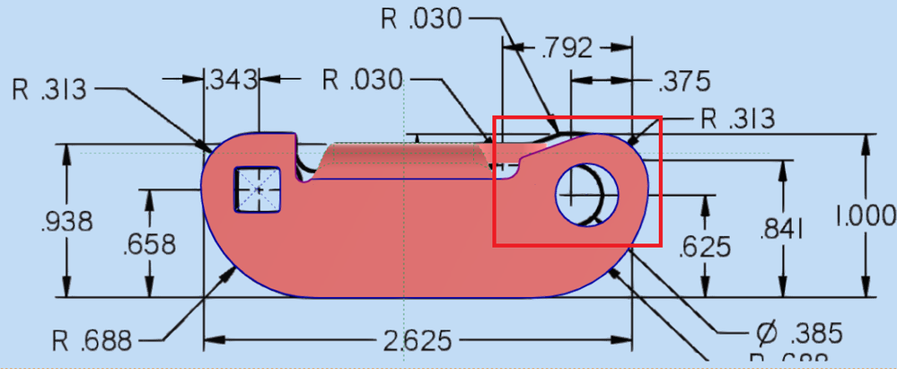

How can I bend the part attached with out bending the whole flange that protrudes beyond the bend.
I tried all fashions of bounding the bend line to stay to the projected part edge.
Thank You

Before I show how I would model this part - what are the intended finished dimensions for these to dimensions in the finished state?

precision
as the model is now
without the flanges with the curl in it
like this that I had to solid model not sheet metal

the part is as such on the tiff file
the only other thing not on the print from the customer is the corner radius of .039.
Message 7 of 51
precision
the flat blank was developed by the customer and a laser blank and forming.

I accept the answers on all the sheet metal bending , I see there is no simple and direct solution to this problem.
The part blank is laid out by the customer and bent and tried out so there profiles are gospel that I have to use.
What I was trying to do was make a simple bend with a boundary so I could fold and unfold it in a progressive die development.
I did play with several other solutions and they all lead to the same result.
My Customer request is for development to be able to stop the boundary of the part without a continuous bend axes.
Thank all of you.

Seems to me the key for this project is possessing a fully detailed flat pattern (blank) instead of a dimensioned 'formed' part. The place where you get 'challenged' is @ the bend transition. That's where you have to mess around w/it till you find a way to do it. That's why I wanted to see @JDMather's solution to see how he handled it.
