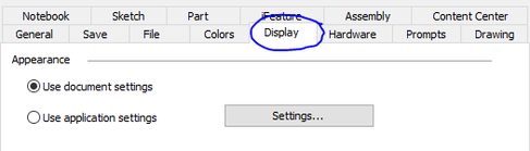

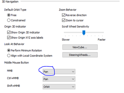

calebEVLCA
There is a better way to swap the controls for Pan and Orbit now. Simply go to File, Application Options, and click on the Display tab at the top, at the bottom you will see the 3D Navigation options and you are able to change the Middle Mouse Button Controls for Pan and Orbit. I simply swapped the MMB control with the Shift+MMB control, as you can see in the screen snips below, which works well as I use Orbit a lot more than I use Pan.
There are also other helpful options like zoom direction included in this 3D Navigation section.

steven.mcalearZFFAF
1. Go to tools/ application options stevenmcalearZFFAF_0-1654196564804.png
3. Set MMB to Orbit and save
