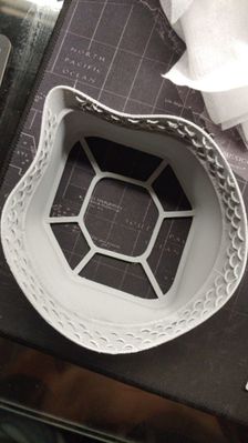

Hi, I am trying to make a mask. yes, sorry for adding one to the list. I have been trying to figure out a way to replicate/pattern extruded features along the surface of the non-geometric shape of the mask. Please help!
Goal:
  1. To replicate/pattern extruded features along the inner surface of the mask
  2. Adding about 2 more rows of the pattern above.
I guess it's a pretty straight forward question. Hopefully, it's a pretty straightforward task. Attached a sample STEP File.
HAPPY NEW YEAR & THANKS, A BUNCH IN ADVANCE!!!

Hey @johnsonshiue ,
Thanks for the reply!
johnsonshiue
Hi! I think the workflow is similar. I guess you need to create parallel workplanes from top. Then create 3D intersection curves. Pattern the the surface along the intersection curve.
Many thanks!
Software Test Engineer
Hey @johnsonshiue,
I've tried but the extrusion ends up halfway offset into the mask itself. I think it's because I reference the edge of the mask instead of the actual path of contour to the extrusion. But I get I can project cut the mask at the sections the extrusions will be.
