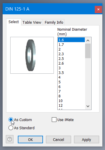

as Johnson suggested and you know, you can define folder, where IPTs generated by Content Center are stored.
This folder is/gets type of "Library" folder, which means files stored there can't be modified. By default (and it is not possible to change) Bolted connection generates bolts/washers/nuts in this "Content Center Files folder". So currently it is not possible to have Content Center files editable.
Only one existing way is instance content center part As Custom, but as said, Bolted Connection does not allow it, Bolted Connection always generates content center parts As Standard under library folder "Content Center Files folder"
Regards
Jan Priban, Autodesk Content Center team
