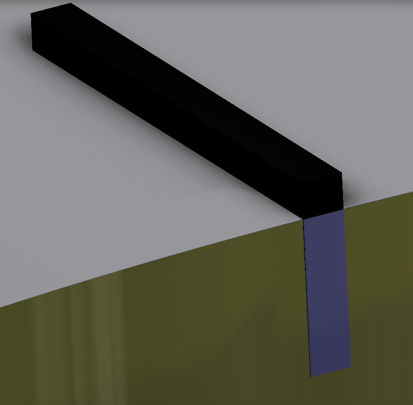

Do you realize that this line is not Horizontal and therefore you have a cone rather than a cylindrical face?
