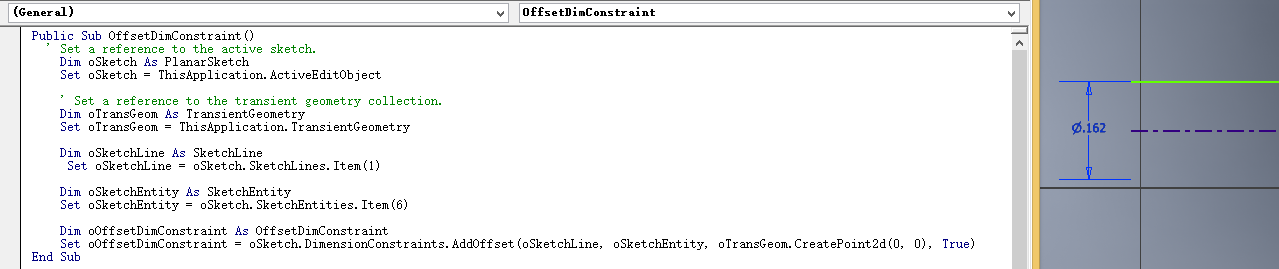

I would like to explain my problem in detail.
I have selected these two lines from the code, Line 1 and Line 2  (marked in red).
And I have the Line1 start point and end point as (0, 3.5) and (3, 3.5)
and Line 2 which is a construction geometry line as (0,0) and (31, 0).
Now, what I need to do is to add the linear diameter dimension (ᴓ7) (marked in yellow color) using API of these two lines.
I hope I am able to explain my problem.Please help me.
Regards,
Message 5 of 10
Xun.Zhang
I am a bit confused, do you want to add a linear diameter dimension between those two lines? is it correct? so which point is the start point and which one is the end? suppose start point should from one of line, right?
Could you help give me more details on the expectation result with a snapshot or sketch to show how the dimension lies finnally.
Thank you so much!
Xun
Message 6 of 10
I am sorry for the confusion.
If I am not wrong, in order to create the linear diameter dimension we need to select the lines or with the points, right?
So for that, I select the two lines Line1 and Line2. The Line1  has its start point and end point and so with the Line2.
I do have the information of both the lines but what I need is to get the distance between these two lines (linear diameter) using API.
In the previous image, I created distance (marked in yellow)from the Inventor, but I need to create that dimension using API.キャプチャ1.PNG

Hi, Clear enough now.
please try below transcription.
Public Sub OffsetDimConstraint()
' Set a reference to the active sketch.
Dim oSketch As PlanarSketch
Set oSketch = ThisApplication.ActiveEditObject
' Set a reference to the transient geometry collection.
Dim oTransGeom As TransientGeometry
Set oTransGeom = ThisApplication.TransientGeometry
Dim oSketchLine As SketchLine
Set oSketchLine = oSketch.SketchLines.Item(1)
Dim oSketchEntity As SketchEntity
Set oSketchEntity = oSketch.SketchEntities.Item(6)
Dim oOffsetDimConstraint As OffsetDimConstraint
Set oOffsetDimConstraint = oSketch.DimensionConstraints.AddOffset(oSketchLine, oSketchEntity, oTransGeom.CreatePoint2d(0, 0), True)
End Sub
Xun
Message 8 of 10
Thank you very much.
It solved my problem . 🙂
