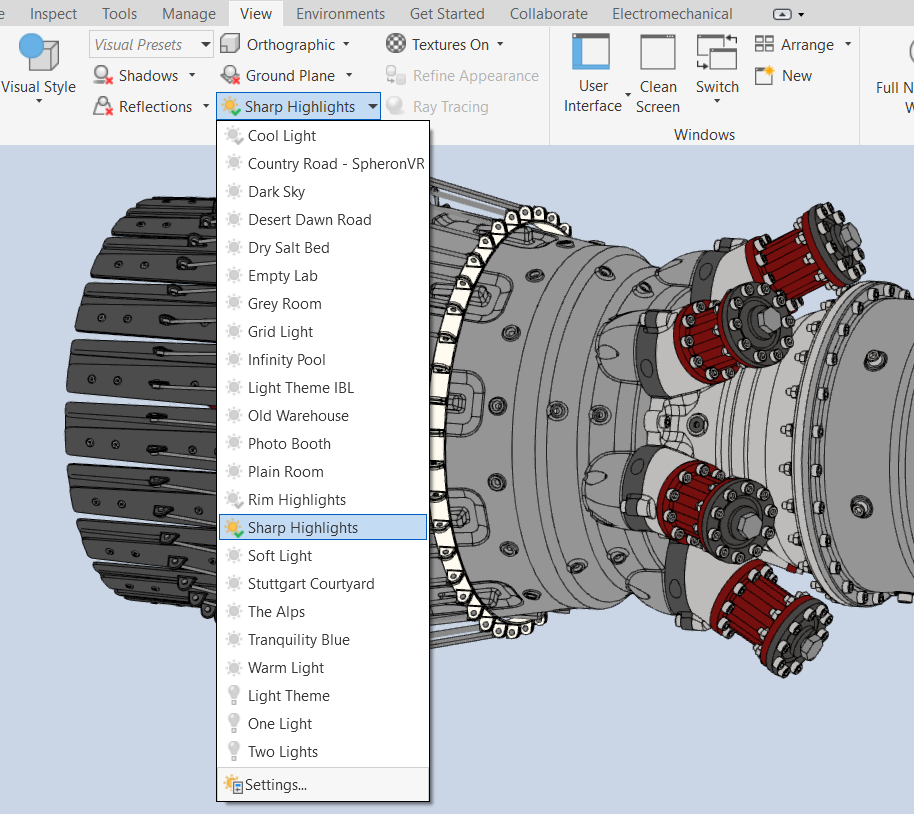

Try different lighting environments.

Hi JD,
Changing the lighting doesn't seem to affect technical illustration in any way (both adjusting brightness and changing the lighting preset). I don't think the problem has anything to do with the lighting, as I said in my post, I'm using identical settings in 2018 as I did in 2016. The issue is with how Inventor chooses to shade the parts.
