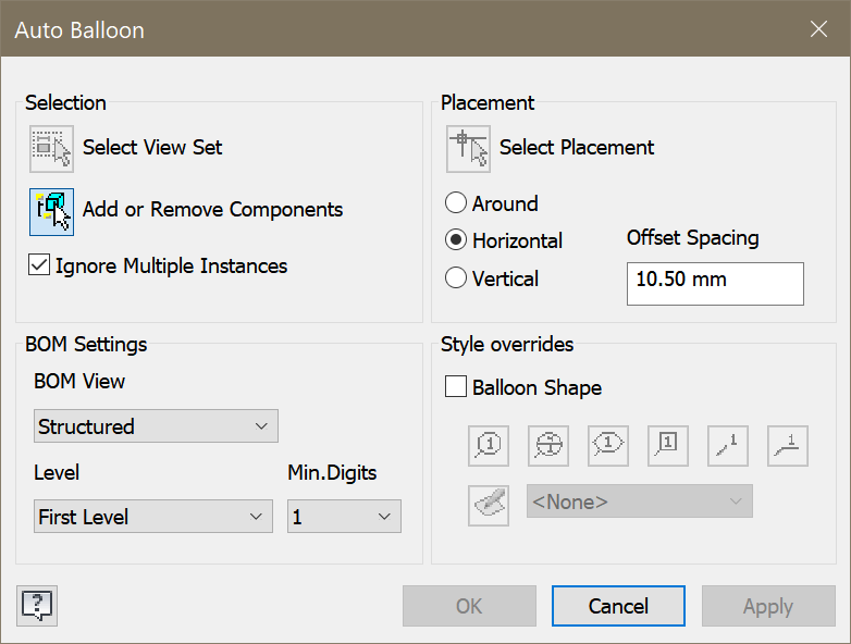

Well, to my surprise, when I tried Auto Balloon again the dialog allowed me to select the view (if you check above it has not done so in the past).   Note: this time there is only a single view on this drawing.  However, when I have selected the view and my options the OK button is deactivated.
190122-AutoBalloonNoOK.pngWe are getting somewhere but not all the way.
BTW: the reason for the second view in the previous drawing (which was ballooned manually) was to allow vision of the bearing and circlip in the Support.

Sergio.D.Suárez
I try to tell you before it is what you should select in "select location" to define the location on the drawing sheet. And previously you must select through window selection in the model view in "add or remove componets", and then the ok button will be activated.

Message 17 of 22
Vagulus
I have selected the view.
Auto-balloon simply does not want to go any further.

Message 18 of 22
Sergio.D.Suárez
Just where you see in the image the selection is complete, you should select placement by clicking on the icon and then clicking on the screen where you want to place the balloons

Message 19 of 22
johnsonshiue
Hi! I am sorry if I repeat similar comments. I think you may want to uncheck "Ignore repeated occurrences" option in the dialog. Unchecking the option will ensure all balloons are unique. Does it help?
