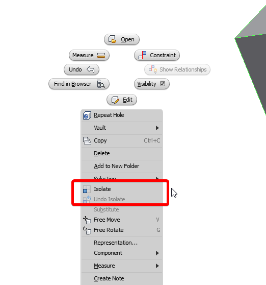

Do you expect them to show up in the assembly? if you don't really care about having it on the part and you will document them on the assembly drawing then you can use assembly hole feature and filter affected lugs with Add Participant / Remove Participant components.
TIP: if you isolate the components before doing the assembly level hole it will only affect visible components. Undo Isolate and select a different set before creating the second hole.
