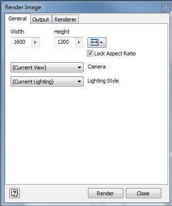

you can also try (within Inventor Studio) adjusting your Image Save Options and Render Image Size Options.
The larger the image output the higher the render quality.
I typically would render outputs of 4000 X 3000 pixles (8000 X 6000 - leave rendering overnight).

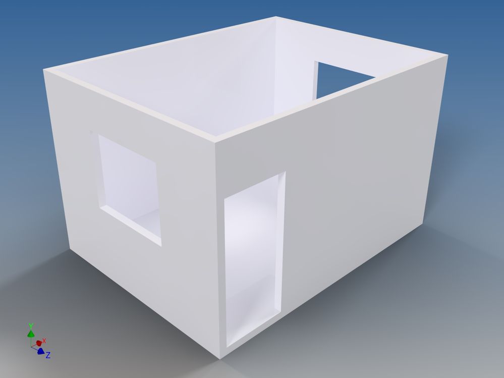

Or just try good old Inventor File => Export => Image => Save as JPEG => Options => X by Y pixels image size required.
