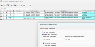

Before I go reinventing the wheel, could someone kindly confirm for me that Inventor can or can not give us this result out of the box.
With a weldment frame:
  • I want to have parts rolled up to show an item qty for each member that is the same part number ( ITEM QTY = 2 as shown)
  • I want to assign part marks for each instance to mark them with unique mark numbers, I can do this using Instance Properties
  • I want to list the mark numbers for each part number as shown in the parts list ( M01, M08)
    • This does not seem possible without manual input or some iLogic to automate this.
    • So this is the part I'm asking about, is there a way to do this "out of the box" ?

So, you want this
to include "comma separated list of values"

Hi Curtis
I managed to achieve part of your goal.
The markings in the view are ready.
However, I'm having trouble getting these items on the parts list and I admit I don't remember how to achieve this.
Balloon descriptions are just a matter of defining the style appropriately in S&SE.
However, at the moment I do not know how to change the content in the table from "various values" to an actual list of these values.

Hi Curtis,
I could be wrong but I believe you will need to use Group Settings to do that. Please feel free to share the example files here or send them to me directly at johnson.shiue@autodesk.com. I would like to understand it better.

Thanks everyone (and extra thanks @kacper.suchomski  for the extra effort of setting up your own data set) , I had intended to include my simple set but got distracted, but here it is, the files are Inventor 2025 files.
I tried to configure the group and substitution settings, but I can not get them to give me the list of Mark Numbers.
But admittingly it's been a long time since I've looked at those settings, so I might be forgetting something.
