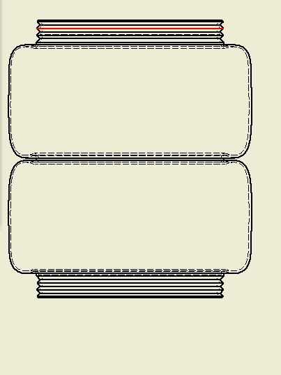

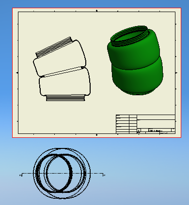

I have a part that refuses to display properly in orthographic drawing views.  The image below shows how it renders in a drawing.  The drawing view to the left is the problematic one, the iso view to the right is just to show what the part actually looks like.
Funny thing, though, when the drawing view is updating (with the green brackets around it), the lines show just fine (see below).  But they disappear as soon as the drawing is fully updated.
I have attached the offensive part and the drawing shown in the images.
I tried turning on tangent edges and interference edges, but no luck.

Seems to be linked with the bend if you roll up the end of part above your bend it shows..

Thanks for taking a look at it.  I noticed that too.  I have a hunch that Inventor just can't compute the complex spline that results after the bend.  But it does just fine in the temporary image that is shown during view computation, and iso views seem to be ok, so...?
How can we have confidence in the software if stupid little things like this make it impossible to document our designs?
Edit:  It seems to work in every other orthographic view except the one I need! Smiley Mad

The edges show up fine in a partial detail view, as long as you don't include the entire edge.
I even tried it modeling the part as a solid instead of surfaces and it has the same results.
Veeeerrrry strange!!!

Hi! The behavior exhibited by the files is not correct. The sihouette should be shown in the views. I am forwarding it to development for further investigation.

The strange thing is that the line is visible in a drawing of the single part. (Picture below)
It isn't visible in the assembly where this part is used. It doesn't show the bottom line of the part.
In raster view, the line is visible. In normal view, it isn't.
I've included a small view from the assembly below to try and clarify.

Hi Tyas,
I believe I have seen this before (it was reported before). This has something to do with the process of culling (removing small detail components in the background from the drawing view) to boost performance.
Sometimes, Inventor makes a bad assumption and removes small components too aggressively. To test my assumption, you can hide some components that block the "missing" parts. You will see they appear correctly afterwards.
Please feel free to share an example with me directly johnson.shiue@autodesk.com. I would like to understand the behavior better.
