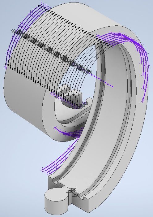

Here is the unclean version now how about you guys just tell me how do I properly go about implementing the fresnel integrals into the equation curve tool since apparently it wont let me just copy/paste the ∫ symbol into it
stop wasting my time and just tell me how to use integrals already 3.jpgstop wasting my time and just tell me how to use integrals already.jpgstop wasting my time and just tell me how to use integrals already 2.jpg

You can't enter an Integral as an equation in Inventor.  Integrals are not used to plot functions.  You can enter the clothoid function in Inventor.  There are a few different ways to approach this, but the easiest I found is to use a 3D equation curve.  For the x-coordinate, it will be a function of Cos (t) and the y-Coord will be a function of sin (t).  I am not sure of some of the constants you are working with, but this is what I came up with for a sample curve.
The function that I used for this is:

Thank you for getting the closest answer but is there one to make a perfect clothoid?
https://www.physicsclassroom.com/Class/circles/u6l2b2.gif
Message 14 of 15
karthur1
"Perfect" would be left for interpretation.  Here is a webpage that will plot a parametric equation. With this you can quickly see the shape and tell if it is where you want it to be.  You can always scale it and get it where it needs to be in Inventor.
