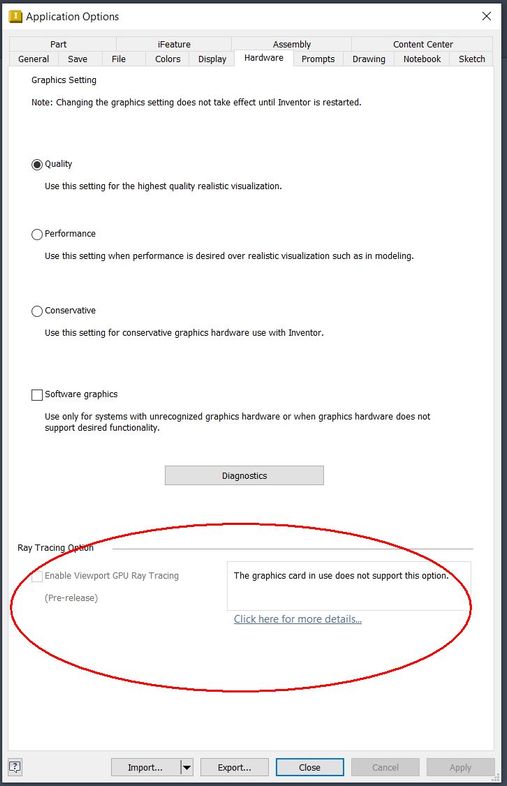

I just installed Inventor 2023 and noticed I can't use the "Ray Tracing Option" in the hardware tab
I tried new drivers from Autodesk Certified list and also new drivers from NVIDIA but no change
Is there something else i forgot to change/check??
Or is the card (1 year old) not up for this?

Not available for the Pascal ("P") generation of cards.

mluterman
The feature you circled, "GPU Ray Tracing".

johnsonshiue
Hi! Please take a look at the Graphics Card requirement for this particular option.
https://help.autodesk.com/view/INVNTOR/2023/ENU/?guid=GUID-541FB861-54C5-4D90-851F-575EFC15EC0C

Mustang69
Thanks!
There are some option for me to choose from! 👍
