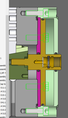

mluterman
I never paid attention to this before, because I guess I would always click "End Section" before creating my selection set, but I would rather know if I'm missing something.
(Edit: I'm talking about selecting with a window, not picking the items one-by-one).

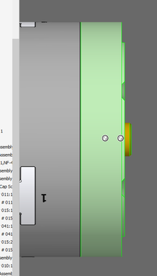

mluterman
It's "select". Please see below. When I have a half-section active and do a crossing window to select items, I am only getting the content center items (whether or not I am in component or part priority).
When I  end the section view, I get what I expect (everything in the crossing window at the set priority-components or parts).

mluterman
Hi Johnson, if you try what you did in your video and use a crossing window instead, you will see the effect I am talking about (you won't see it if you pick or hover over the items individually as you did in that video). It seems like the crossing window selection method is deactivated when there is a section view active (but I need to see inside while I am selecting with crossing window, and it seems impossible).

NigelHay
With my example that is not the whole description. In the attached screen shot, I've used a crossing window to select the whole assembly. In the browser you can see that it has selected some but not all of the user created parts i.e., 1208 & 14490PR selected but not 12371J & 12891C. Towards the bottom of the browser you can see that it has selected some but not all of the B0015 screws. These are all the same model & are renumbered content centre parts.
I can understand that some parts are not selected because they are in the 'invisible' area of the half section but a lot of those unselected parts are fully circular & should have been picked up.
